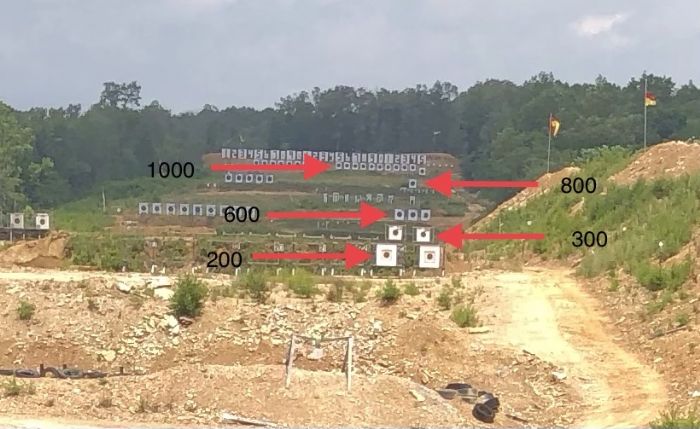

Went to a range near Spencer, TN which has electronic targets from 100 to 1000 yards.  The targets are NRA High Power military type targets, Short Range (SR) at 100 and 300 yards.  Mid Range (MR) at 600 yards and the Long Range (LR) target at 800 and 1000 yards.
I wanted to shoot my UF56 No. 4 Mk 2 DCRA conversion out to 1000 yards.  PH 5c rear sight fitted.   I loaded up 50 rounds of 175 gr. SMK’s with 40.5 gr IMR 4064.  It’s a bit “light in the pants” for a .308, but I’m trying to minimize bore wear and keep the load on the action down.

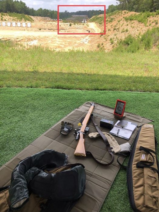

All shooting was done on my belly, prone in sling, no support under the rifle.  A bit of a shifting wind from 8:00 to 9:00.

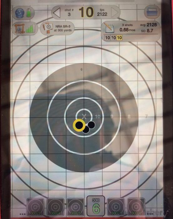

At 600 yds, this load really performed holding the 10 and x ring fairly easily.  I’ve shot this rifle numerous times at 600 but never further until today.

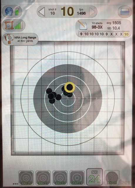

Moving out to 800 yards, my first shot was a 9 at 2:30.  Added 2 MOA left windage, my second shot was just out of the 9 ring at 9:00.  Too much adjustment.  Came back 1 MOA right windage and next two shots in the 10 ring.
What impressed me is the elevation spread was only 1.5 MOA.  That’s pretty darn good for a Lee Enfield with aperture sights.  Windage spread was more because I fiddled with the rear sight windage setting.
 The photo below shows the 800 yard target monitor showing the mean velocity (at 800 yds) as 1295 fps and a standard deviation at 10 fps.  Pretty respectable SD.  The rifle can shoot quite well at 800 yards.

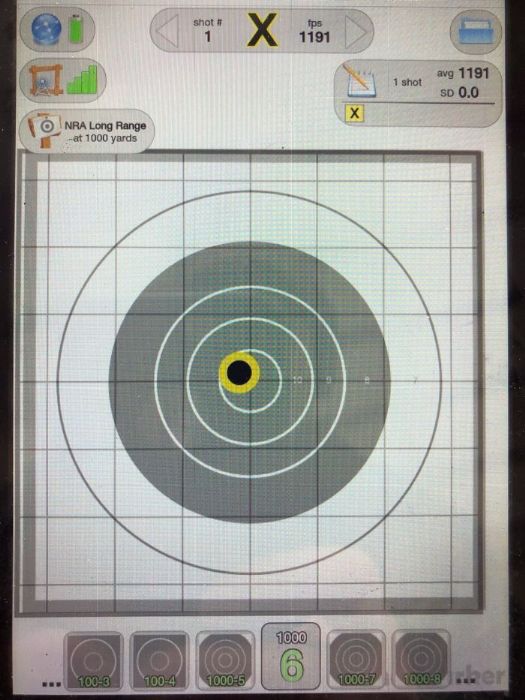

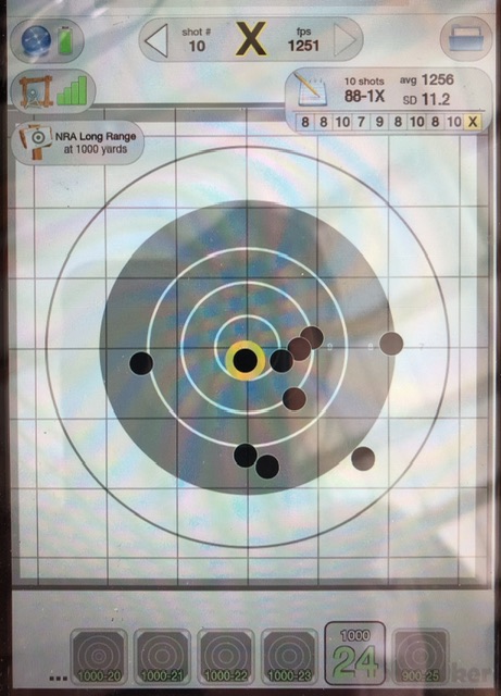

Then on to 1000 yards.  Had to crank up the rear sight elevation to nearly 40 MOA.  First shot, no indication on the monitor, nor the second nor the third.  Well, crap.  The bullet is traveling too slow to register on the electronic target, it needs to be going above the speed of sound, over 1100 fps.  So, I took aim at the 24 inch steel plate.  That 24 inch plate looks like a tiny white speck at 1000 yards. I could barely see it.  The RO watched thru his spotting scope and said I kept nicking the edge of the plate, scarred the crap out of it.
Here is the rear sight elevation for 1000 yards.  The .308 with 175 gr Sierra MatchKing has a slightly flatter trajectory than the Mk 7 .303 service bullet, note the range scale on the aft side of the rear sight base is aligned to 900 yards
If you look all the way down the range, you will see a white streak of the 1000 yard target line.  My biggest problem was figuring out which target was mine, I could not see the numbers on the number boards because my shooting glasses are set to focus on my front sight.

All shooting was done prone in sling with no support, working my way down the range starting at 100 yds, then 300, 600, 800 and 1000.  These 5 different ranges have electronic targets that record the bullet velocity and shot position on the NRA Target overlay on the monitor.  The targets are the current US NRA Military type targets:  SR-1 at 100, SR at 300, MR at 600 and LR at 800 and 1000.
The Strelok velocity and elevation setting predictions were surprisingly very close!  Generally within 20 fps and 1 MOA.  I was very surprised by this.  The actual velocities were slightly less than predicted.  I attribute this to the high pressure area that moved in last night resulting in clear skies by the morning. Adjusting for actual pressure put the predicted velocities to within less than 10 fps from actual.
Load 1 turned out to be marginal for triggering the target sensors at 1000 yards.  About 40% of the hits displayed a warning that the velocity was too low, but it did show the hit location correctly (according to the RO).  This warning required the monitor to be cleared of all hits before proceeding, if not, subsequent hits would not register.
Load 2 was of course slower than load 1 at all ranges up to 800 yards where it was about equal to Load 1, but at 1000 yards, it was about 20 fps faster than load 1.  This is entirely a result of the higher BC of the 175 gr TMK over the 155 Palma MK. This bullet is the ticket to reliable recordings at the 1000 yard line.
My approach was to fire as few shots as possible at the Short and Mid ranges to reserve ammo and minimize shooter fatigue for the Long Ranges. Once I had hits in the 10 or X ring, I moved on to the next range after collecting actual velocity data.  The loads really performed, standard deviations were 10 fps or less for Load 2, a bit higher for Load 1.
Here is the 300 yard target with Load 2, three shots were sufficient to confirm elevation settings.  This three shot group was only 0.68 MOA extreme spread. Note the standard deviation of 8.7 fps.
My windage estimates were a bit off at 600, but I was happy with the elevation spread at 600 yards with both of these loads.  This is Load 1.
At 800 yards, I struggled to keep consistent elevation, this is Load 1 and I overcorrected for my first sighting shots that were low.  Then undercorrected, but pretty tight windage spread.  Note that the grid overlay on the monitor (an IPad) is 1 MOA on all these targets.
Then on to 1000 yards.  My first sighter was a ….
By the end of the day I had shot 80 rounds and was whipped.  The final 10 shots at 1000 yards with Load 2 was showing signs of fatigue and pain.  4+ hours of prone shooting with extreme focus and concentration is very tiring.
Regardless, not a single shot was outside of “the black” on the Long Range Targets, including my first sighters. That was better than I expected, because that 44 inch black aiming mark on the LR Target looked incredibly small at 1000 yards!  That was very satisfying. My scores were in the low to mid 90’s for ten shots at 800 and 1000.  Not competitive for modern Palma Match shooting (which uses much more accurate rifles with 30 inch heavy barrels), but I believe these results are on par with the 1967 Palma Match results which used these DCRA converted rifles.

And finally, 1000 yards, really struggled with the wind. My first sighter was a 10, no further adjustments made for elevation (30 MOA above my 100 yd zero setting).  The last shot was an X, always like to finish strong Smile
I’m not entirely sure if the not so good performance today was me, the load, or both.  I did have several shots off that I called, and I failed to compensate for the wind when it became obvious it had changed direction (fishtailing from behind me, note the 2 consecutive 7’s at 9.

Far in the distant horizon just below the trees is the 1000 yard NRA Long Range Target, a 44 inch black aiming mark encompassing the 8 ring.  The 10 ring is 20 inches in diameter with a 10 inch X Ring.
First, the 155 gr Palma Load at 800 Yds. First sighter shot was a 9 at 11:30.  Sight adjustment put the second sighter in the X ring.  10 shots for score gave me 95-2X.  This was an improvement over my previous load with this bullet, but the vertical spread was a bit much for my liking, 2.7 MOA.
Next, the same 155 Palma bullet load at 1000 yards.  Note the change in Firing Point number, the RO kindly offered to move me to the far end of the firing line (where the first pic was taken) so I could lay on the nice soft turf and be away from all the guys with their muzzle brakes blasting right next to me.  Much better! I dispensed with the sighters here, the first two shots were right on for elevation, but in the 8 ring at 9:00 and 3:00.  That was me trying to figure out this changing wind speed.  Elevation spread was a bit better than at 800 yds at 1.8 MOA. I suspect those three low shots were my aiming errors.

The Long Branch 7.62 barrel really likes these 168 TMKs, and it showed on the 200, 300, 600 and 800 yard targets.  Unfortunately, I was just too tired, too hot, and a bit beat up from shooting about 75 “full power” loads.  To be specific, the loads were about mid range for .308 Win per online Hodgdon reloading data, but much hotter than my standard loads for the No. 4 in .303 or 7.62.

Edited to add a few photos of the firing point and zoom in on the down range targets.
And zoomed in on the red box. This is about what it looks like at the 1000 yd target thru the sights, maybe even a bit smaller than this. The far right target, firing point 25, is actually at 900 yds, so it appears to be a bit lower than the others. The nice thing is you can shoot at any of these targets without having to move the entire line of shooters.
