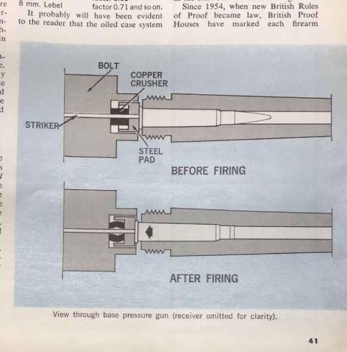

There actually is no issues with that PSI rating. The 303 British has a CUP (Copper Units of Pressure) of 45,000 CUP
On the Piezo Scale using a conversion tool, that equates to 50262 PSI
Your 42,560 PSI equates to 35,680 CUP. The U.S. military pressure tests are even lower than the Copper Crusher Method.
I have been continuously using 41.5grns of IMR4064 under a .308 168grn BTHP. Hodgdons data indicates a PSI of 43,800.
Using a conversion tool, that equates to 37,181 CUP.
That is -7819 CUP under the British Ministry of Defenses established 45,000 CUP.
If you stay right at or under 42.0grns of VVN540 using the 155grn Scenar-L, your pressures should never exceed 45,000 CUP/50262 PSI.
The choice is yours to do with as you see fit however...

The 19 Tons Per Sq In is much more than 42,560 PSI Piezo Peak Pressure.   The British system of chamber pressure measurement is incompatible with both the US Radial Copper Crusher units and Piezo Peak Pressure Methods.  There is really no accurate way to convert the pressure in one method to the other.  The British system uses a copper crusher, but it is part of the bolt assembly in the pressure test rig.  An oiled cartridge is used acting as the piston.  So it is an axial pressure measuring system.
19T represented the average maximum pressures of the 7.62 NATO ball ammunition being used at the time in British service. That pressure is indeed lower than the SAMMI and European Standards for the .308 Winchester.  But the loads you described would very likely be within 19 TPSI using the British Axial Pressure measurement system.  The 7.62 Converted Rifles were actually Proof Pressure tested to higher pressure than 19TPSI.

@britrifles: There is an Armory here in the Metropolitan Phoenix area that does Proof Testing using the Piezo Scale. They also have an ancient Copper Crusher test stand that they can use but its more of a museum piece. As a Sidenote; They also have an authentic Enfield Rifle Rest on display.
I took my Canadian Arsenal 7.62mm barrel to them to see if the 22.3 Ton proof stamp matched or exceeded that number. Their test did confirm the 22.3 Ton proof stamp. During the testing I asked if there was a formula/conversion table for CUP to PSI and vise versa. There is and it was shared to me. The OP mentioned his concerns and I gave him honest and viable answers to those concerns based off of my knowledge that was shared to me by a very highly rated testing facility. While you will agree to disagree with me on this topic, the fact remains that, what I offered is valid and validated by the above mentioned testing facility.
I don’t see anything here that I disagree with Goosic.  Although I’m not sure I understand what you mean by the armory “did confirm the 22.3 Ton proof stamp”.  I assume it means that they looked at it and understood what it meant.
There is indeed an empirical relationship between Radial Copper Crusher method and the Piezo Peak Pressure method.  The formula is an approximation that minimizes the errors in the conversion formula throughout the typical range of cartridge pressures.
I’ve not seen any similar empirical formula for the British Axial (Cartridge Base) copper crusher method however.  If you know of one, please share it.
What is quite nice about the British Base Pressure method is that it does not require the barrel chamber to be drilled for the insertion of the piston to obtain the pressure measurement.
