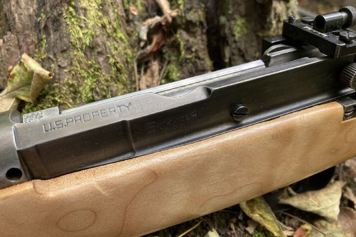

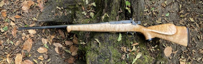

Stumbled over this in the back corner of a small LGS Smile  One piece conversion in a Robert's Wood Product stock.  The front sight is a puzzler, no sign the was ever one on there (other than the original one) but the bluing looks like it was redone after the barrel was cut.   Had a hard time finding ammo, so I've only fired a few rounds into the hillside to make sure it goes *bang!*  On one hand getting a ramp front sight would be keeping with the conversion, on the other hand my eyes like scopes much better, so thinking about one of the Red Star Mountain mounts and an older Leupold 3x I have tucked away
https://archive.org/details/roberts-wood-products-gunstocks
Date Posted: August 26 2022 at 4:20am

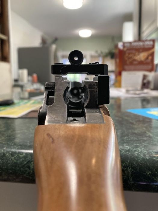

Nice receiver peep sight, but not very useful without a front sight!  The barrel must have been cut back removing the front sight block band and bayonet lugs.  What is the barrel length (back of chamber to muzzle)?
The rear sight ears on the receiver have been ground off too, so you won’t be able to install an original rear sight.  Scope is probably your best bet, although your choice of mounts will be limited to ones that don’t use the rear sight axis pin lugs.
The rifle is of course a Savage made No. 4 Mk I*, not a Mk 4, which is an entirely different rifle (.22 conversion of the SMLE Mk III).
Updated and corrected the post title, thanks for that heads up! Beer
The barrel is 21.0625" and has a nice rounded crown. I have pretty much settled on the Red Star Mountain mount for the reasons you mention and that, at least in my opinion, the other side mount scope options are an affront unto the Lord.  The stock will allow for a slight adjustment in head position to make a scope usable without a cheek piece if the scope is low enough, which that mount should provide.  My challenge at this point is finding a 'smith that would tackle this without wanting to make a boat payment or spending 20 minutes explaining why I should dump this and get a (insert some other random rifle name here) because those are REAL rifles Ermm

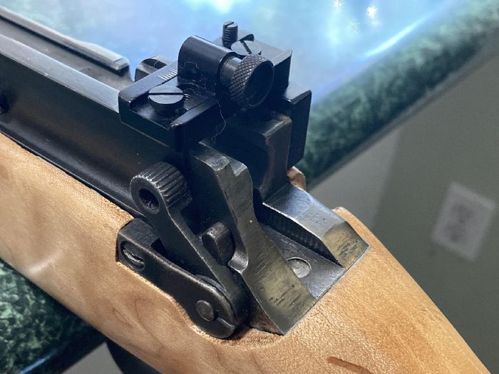

One of those Parker Hale scope mounts Goosic had would work. Ashley "no drill" mounts use the "ear holes" as one of their anchor points. Maybe get a globe front site sweated on?

The RMS scope mounts, the No tap or the Repro Sniper bracket will not work on your rifle. The way the reciever is cutdown leaves you with two choices. Try to find the very rare Redfield barrel mounted scope mount or get a Parker Hale A29 scope base, drill three holes, tap those three holes, secure the base and then find a flat base scope mount to fit a scope to. The rifle is beyond restoration so, do with it as you see fit. There is a topic here somewhere that discusses making your own mount using a piece of angle iron and mating that to a Weaver style flat based scope pad. I make my side mounts using angled aluminum.  The quick fix would be to get a Williams front ramp sight and sweat it to the barrel so it matches the Williams peep sight already affixed...
Date Posted: August 26 2022 at 1:31pm
The Parker Hale mount shown above would fit the era of your sporter as I think they were made for that specific purpose on No4's. I'm my opinion, it would look right at home on your rifle!

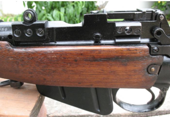

The RMS scope mounts, the No tap or the Repro Sniper bracket will not work on your rifle. The way the reciever is cutdown leaves you with two choices.  . . .
Why wouldn't the repro Sniper bracket work?   Looking at this photo from some RMS mounting instructions it looks like it *should* work, but I'm pretty new to this mount.
There might be enough material left to use that setup but, unless your chosen gunsmith knows exactly what he is doing, the chances of that scope mount getting zeroed over the center of the rifles bore is slim to none. He would have to mill away at least 5-8 thousandths of an inch  square where the front pad is to sit and then slowly remove material from the front pads thumb screw mount until the scope is collimated over the center of the bore. I have a similar reproduction sniper scope mount and followed the strict advice of Peter Laidler to get the desired results for my 7.62mm conversion. ..

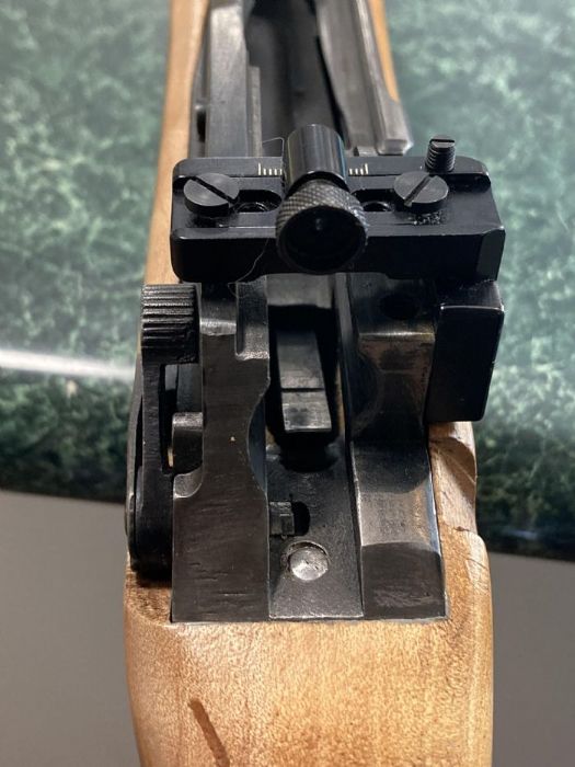

Let me know if there are any other angles you want to see.   The front trigger guard screw attaches to a small block glass bedded in and is only used to secure the trigger guard  Near as I can tell on my bathroom scale it weighs in at +/- 5.75 lbs
Posted By: yumastepside
Date Posted: August 31 2022 at 12:25am
Thanks for that, they're excellent pictures, that makes a nice light sporter at 5 and 3/4 pounds.
Sorry to be a pain but could I get a pic directly down on the rear tang without the bolt and one from the rear looking forward into the action.

Mauserizing the Enfield!

Date Posted: September 07 2022 at 5:11pm
Originally posted by VinnieBoomBah VinnieBoomBah wrote:
One of those Parker Hale scope mounts Goosic had would work. Addley "no drill" mounts use the "ear holes" as one of their anchor points. Maybe get a globe front site sweated on?
A sweated on ramp/globe/post or something is on the list, but I do have an issue with Mission Creep and spending monnies I don't have  . . .
I have a spare Addley Precision NoTap scope mount that I decided to cutdown and shorten to see if it would be feasible to mount to a receiver that has been cutdown like yours or mine without having to find a piece of angle iron and then an actual scope mount. Initial mockup  looks promising...

Date Posted: September 08 2022 at 7:35am
I don't have another receiver on hand to compare mine to, but from what I can tell the left receiver wall has not been modified in any way, so any mount that only mounts on the left side of the receiver should work OK.   If anyone missed it in my first post, here is the catalogue from Robert's Wood Products that has the instructions this modification on page 20 - 22
https://archive.org/details/roberts-wood-products-gunstocks/page/20/mode/2up" rel="nofollow - https://archive.org/details/roberts-wood-products-gunstocks/page/20/mode/2up
Date Posted: September 08 2022 at 3:10pm
From the pictures the left side receiver wall has been modified in 2 places:
The "square bit, sticking up" for the charger bridge has been removed down to level with the rest of the side wall.
The pivot block for the rear sight pivot has also been lowered to the same alignment.
Neither will be a problem as long as whatever sight mount you use isn't using those place for anything.
Many ND/NT use the rear sight pivot hole though.
Date Posted: September 08 2022 at 3:32pm
Addley does use the rear site "ears" and the ejector screw to mount their system. The three holes pictured in the above mock ups must have been drilled for mounting on the receiver, and material has been removed around the ejector screw I assume for clearance to reinstall said screw.
Date Posted: September 08 2022 at 7:24pm
I drilled the holes and cut the notch out for the ejector screw HT.
I cut the mount down to match my PH A29 scope base. I only did this because there are alot of "Sporterized/Customized" Enfields out there like mine and the OP's that could benefit from a mount like this. It's already centered over the rifles boreline...
Date Posted: September 08 2022 at 8:04pm
Yup. That's what I thought! Looks good!
