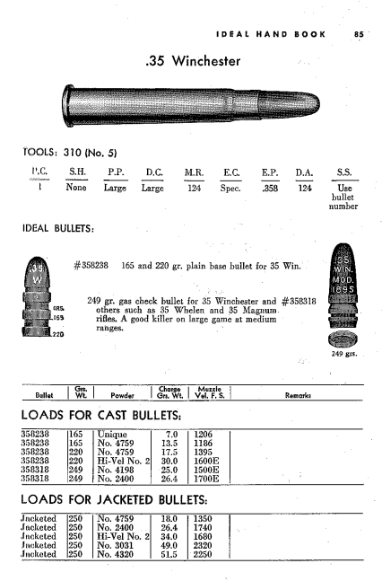

Posted By: BJ72
Date Posted: May 08 2023 at 9:18pm
For anyone interested. Ideal Handbook no 38.
35 Winchester load data. Not many current powders in the list though.
Posted By: BJ72
Date Posted: May 08 2023 at 9:28pm
Appears what I was trying to post in my last reply didn't work. Here's my 2nd attempt.
From the Ideal Handbook no 38.

I have managed to put some load data together that I think will get me started. I still don't have a place to shoot so all of it is on hold for the time being.
Shamu was a big help! ;>)

Date Posted: May 21 2023 at 5:26pm
FWIW, .35 Win data from my Lyman 41st Ed.
Date Posted: May 22 2023 at 4:15am
.358 Win from my Speer No. 7 Manual.  The text says loaded to 54,000 lbs mean pressure, I assume that is CUP, which is higher than the .308 Win.  These loads seem pretty high to me.
This same manual gives max load of 43 gr IMR 4895 for a 180 gr bullet in the .303 British vs 54 gr max in .358 Win for the same weight bullet.  And, I don’t know if the 4895 you buy today is the same as it was 50 plus years ago.
Perhaps use .303 load data and extrapolate back on bullet weight?
Date Posted: May 22 2023 at 4:51am
 .35 Winchester from Lyman 42 Ed.  Again, seems like pretty stout charges compared to .303.  Not sure how a heavier bullet allows for more powder (compared to .303). More case capacity with larger dia. Bullet of the same weight?

Britrifles: Thanks for showing those pages it was much appreciated!

Anyway, thanks for your input, the screen shots of the manuals were a valuable resource.

I also printed out all your pictures to include in my .35-303 Load Manual. ;>)
This is the most useful info I have been able to find in one place during this whole thread.
Thanks again!

I knew these old reloading manuals would come in handy some day, glad I could help Randy.
