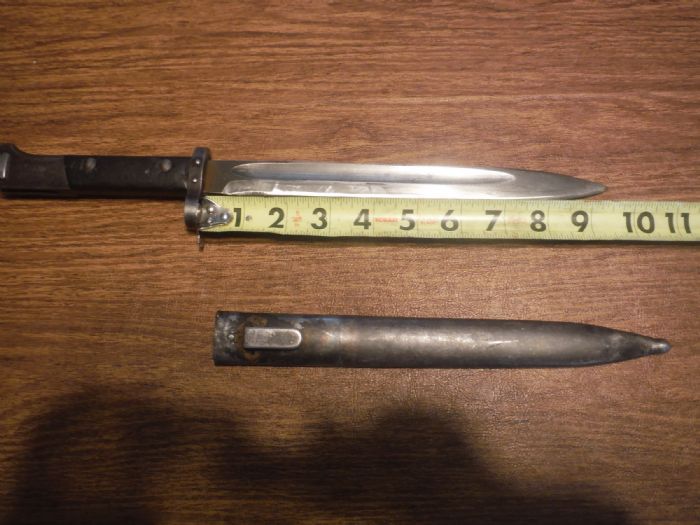

I have a bayonet that a friend of mine got while in Iraq and am having trouble identifying it, hoping some of you can help. It is marked 1871 Enfield, has the govt acceptance mark and is Marked War Dept. The other side has a crown marking that doesn't match any of the crown markings I have seen so far. Below the crown is a B which I believe means Brimingham RSAF, and below that a 32 which could mean Duke of Cornwalls Light Infantry? On the pommel is the marking C308 which I think is a conversion mark but not sure? And on the quillon is a Z with a circle around it. The closest I can come up with is an 1888 Mk III but this WAY too short. Any help is appreciated.

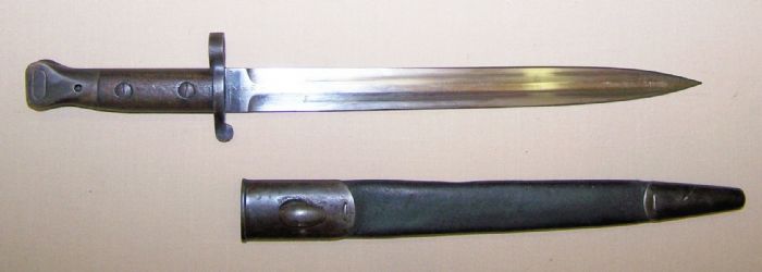

Neither a Pat. 1888 Mk III nor a British bayonet. I guess someone has been having fun with the markings!  Photo of a Pat 1888 Mk III attached.

Date Posted: December 18 2023 at 11:57am
Not even British? Any ideas?

Date Posted: December 18 2023 at 8:17pm
thats was my thought at first , but that is a mauser style bayonet , basically an M1871 , these were used by numerous countries in south america , europe and the middle east , spain , yugoslavia , czechs and siberia had a version M1899 also notably egypt used these in their M1949
it does not have a quillon - were you refering to the muzzle ring ?
Posted By: Shinglhed
Date Posted: December 19 2023 at 4:49am
Yes, the guard. You can see it in the 4th picture.

Posted By: terrylee
Date Posted: December 19 2023 at 6:03am
I have no interest in Continental bayonets, but according to my reference material it is an                  M 1899/1915 Mauser bayonet. I expect that its markings were embroidered in the hope of enhancing its selling price!

Date Posted: December 19 2023 at 4:19pm
actually i believe its authentic mauser and i agree with terry lee that its been remarked - most likely for the reason he stated as that muzzle ring and lock would not fit any enfield , the scabbard looks to be authentic as well ,
as i indicated in my initial post , basically an M1871 but the M 1899/1915 was the later version of that
Posted By: Redman
Date Posted: April 05 2024 at 7:21pm
looks like an Austrian 1895 Steyr bayonet. I've only been wrong twice? RED

Date Posted: April 08 2024 at 4:50am
Looking at the "Crown" stamp..just wondering...could it be DANISH?
Posted By: Redman
Date Posted: April 08 2024 at 7:42am
OK, GOT IT! The Z in a circle between those 2 rivets on the cross guard, screams Czech (ZB Brno Stamp), cause that's what it is! I missed that,  So.. was thinking VZ24 Mauser but looks to be the shorter VZ22 For the 98/22 Mauser. Final Answer!?
