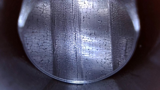

After thinking on this for a few years now, I finally decided it was time to replace the BSA barrel on the 1944 69Lxxxx Long Branch. This barrel was installed by Fulton’s in 1963 on a match prepped (Fulton Regulated) rifle for U.K. NRA SR(b) shooting. The rifle belonged to a friend of my Dads, who never fired it. Dad had not fired it either. I got the rifle almost 30 years ago and I learned to shoot with it.

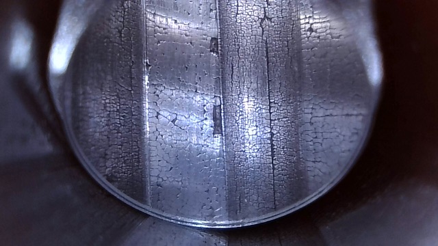

About 10,000 rounds thru the barrel, I wished I had kept a barrel log. It was a very good shooter indeed. But groups had opened up from the 1 to 1.5 MOA range to 3 to 4 MOA and no longer would hold the 10 ring on the US NRA Short Range target. Gone were the days I could put ten consecutive shots into the X ring at 200 yds shooting prone with the standard Mk 1 aperture sight.
I purchased a Criterion barrel several years back with intentions of using it on this rifle when the barrel went. Last Friday shooting it at the range convinced me it was time.

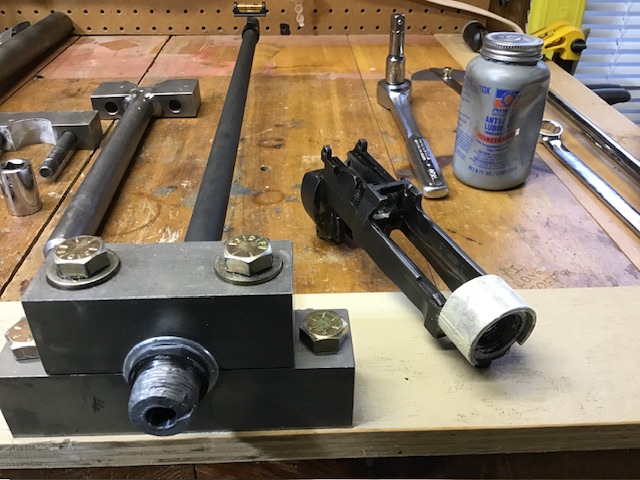

BSA barrel removed this morning. This one came off fairly easily. I use a 3 foot steel pipe extension on the action body wrench. Did not have to use heat on this one, nor cut the barrel reinforce either to relieve the compression on the shoulder.
Cleaned the action body in the ultrasonic cleaner, solution was black when it finished. Took out years of crud.

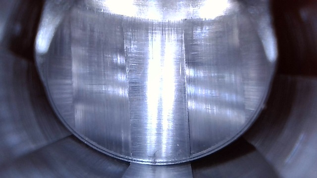

The new Criterion barrel, a 5 groove LH twist, .3025 bore.  174 gr SMK contacts lands at 3.098 OAL with Hornady OAL gage.  The thinnest breeching up washer (.037 thick) gives 14 deg barrel under turn.

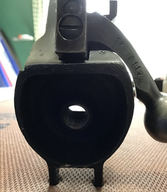

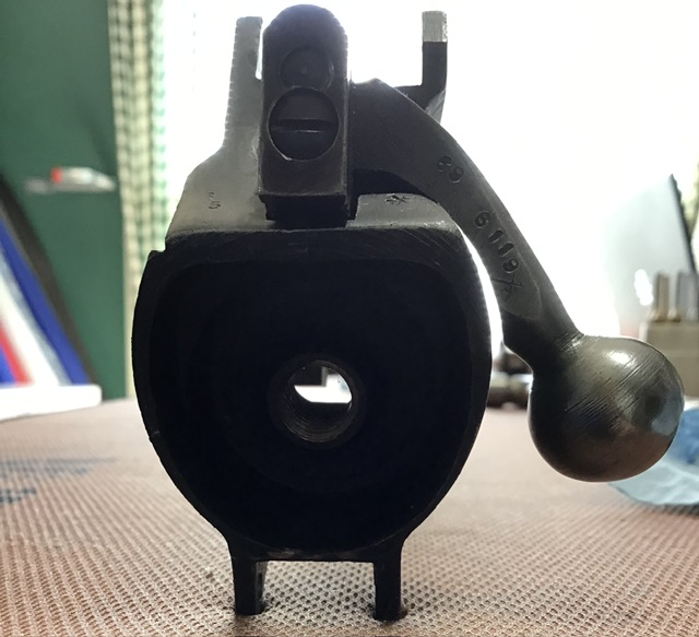

It’s ready to install. Hand tight headspace looks good. Here is the bolt position with the .070 No-Go gage and the #1 bolt head that was on the bolt.
Still have to finish ream the chamber, but it’s pretty close as it is, just a very light cut until the reamer just contacts the back face of the breach.  Headspace and cartridge base to ogive measurements retaken with 174 SMK after finish ream and barrel install.

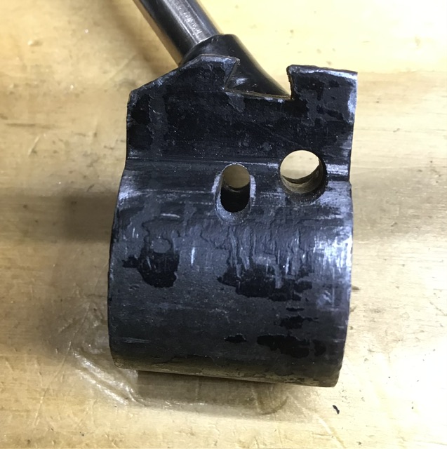

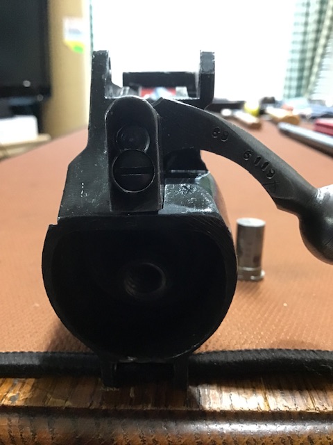

First issue noted, the groove in the top of the barrel for the front sight block pin is not machined into the Criterion barrel. Will probably have to file this with a 3/32 dia file. Can’t see any other way to do it, any other suggestions?
First of all, thank you for this high quality content Geoff.
I would probably do this way:
Set the sight base in position and lock it with loctite contact glue, then, with a lot of care and attention, I would place the barrel in the drill press and with a drill bit of the correct size, then cut… to do a “gross” centering of the drill press and the hole, place the drill bit in the opposite way in the chuck and regulate the vise it until it moves freely in the hole.
I’ll be honest with you, with the fear of messing everything up I would chose the rounded file too, that will give the best control on the situation..
Would you like to show us some other images and some more explanation on how to rebarrel the no.4?
Date Posted: January 02 2024 at 3:47pm
Thanks Dario, I think I will go with the 3/32 inch diameter round file, just take a bit at a time until the tapered pin fits just right. I’m afraid of breaking off a drill bit trying to drill the notch, or buggering up the sight block as the bit will want to slip on the barrel trying to drill a notch tangent to the surface.  I wonder how this was done at the factory, perhaps the hole in the block was drilled when it was attached to the barrel.

The biggest problem I have had is getting the old barrel off.  These barrels are on tight. Finding a workable action wrench and barrel vice took me a while. The set I have seems to work, but it required a lot of sanding to get the tapered aluminum barrel vice bushing to fit the chamber reinforce. Despite being advertised as a Lee Enfield action wrench and barrel vice, the fit to the chamber reinforce was all wrong giving only a line contact.  I ended up wrapping an old barrel I had with sandpaper around the reinforce and chucking it in the drill press.  Then holding the bushing down over the sandpaper to get the right taper.  Even then, the barrel wants to spin in the vice, you have to put a lot of torque on the two bolts that clamp on to the barrel.
One thing I don’t really like about the action wrench is that it relies on clamping forces as well, and it clamps right on the forward part of the action body over the threaded area. This must be squeezing the body down onto the barrel threads, which just makes it harder to turn. I wish I had drawings of the original action wrenches and barrel vice.  I thought about sending the barreled action off to Brian d**k to separate for me but I decided I didn’t want to put it in the mail.

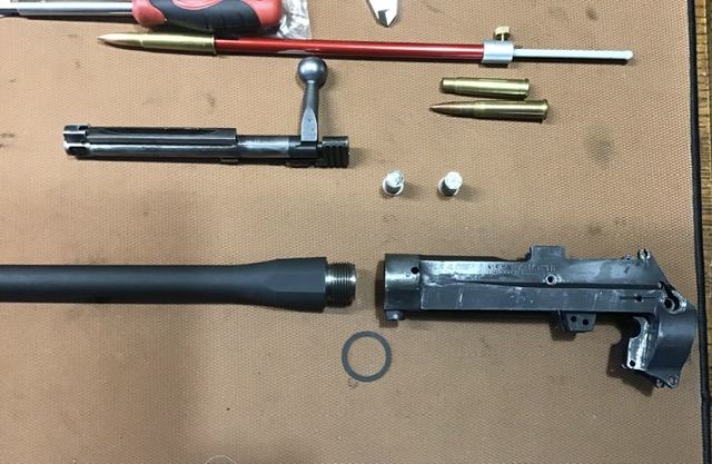

It’s much easier installing the barrel. The Criterion barrel comes with a set of breeching washers of four thicknesses in increments of .001 inch. The thinnest one seems to be the right one giving a 14 deg barrel under turn before applying any torque. The next size gave about 20 deg which I think is excessive.  My measurements of under turn are fairly approximate using an adjustable protractor held on the knocks form flat and movable arm held vertical to the body.

What Ive done in the past, is mark each side of the block onto the barrel with a #2 or grease pencil and carefully file but using a small triangular file.
Ive also used a hacksaw when doing pinning and carefully on other systems opening up the cut with needle files. Like one would do when making a dovetail.
If its done this way, the edge of the cut can be peened over to tighten up on the pin if necessary.
A trick associated with using a hacksaw blade is to grind one side of the teeth off. That way you can control the width of the cut and keep the cut straight. This is a good method for fixing buggered screw heads that are just peened over and dressed off nice and smooth again.
As for how it was done originally I always assumed it was done primarily by hand fitting on initial assembly.
The reason for my thinking is, sometimes when swapping barrels stocks and what have you, the block for the sight will interfere with the front of the stock and the sheet-metal bands that reinforce it.
Often theirs not much room to work there if the original slot has been cut because of the diameter of the pin and how distorted they become.
For this reason I would assemble the fore-end to make sure the block is positioned correctly. Every once in a while one will need moved front a touch. The good news is, the lugs on the barrel will keep the block straight and keep it from wiggling left and right when you file. Just make adequate clearance to the stock is available.
I use the attached fore sight block (a clean machined one) to index the barrel with levels once its coming up to tight and then you can check it on a heavy piece of glass or a scrap of that ground granite they cut for counter tops by turning the barrel over to the block and the sight ears on the make do surface plate. Sometimes yo need to lever them a little bit to get them just so.

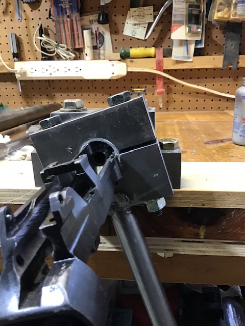

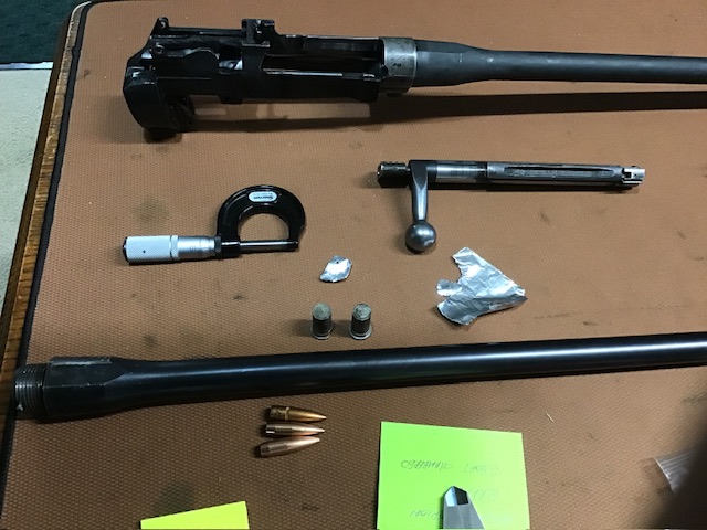

The breeching up operation is complete.  Installing the barrel is much easier than removing one!

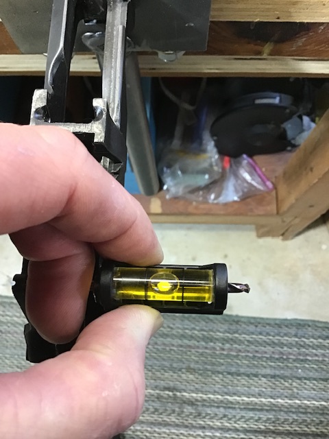

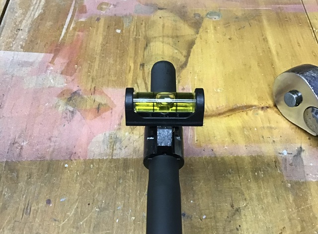

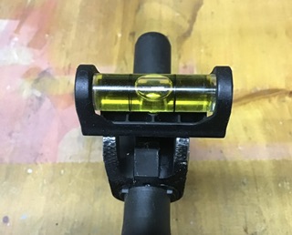

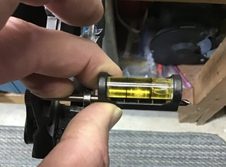

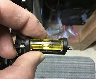

First, get the barrel leveled in the barrel vice. Unfortunately, can’t use the flat on the Knox Form as it is hidden under the vice bushing. I use a spirit level along the top of the front sight block band.
Barrel clamped up very snug, using a 2 foot ratchet and socket on the vice bolts. Powdered rosin on the reinforce and both surfaces of the aluminum bushing and the inside surface of the barrel vice.  Anti-seize lubricant on the barrel threads. Action wrench aluminum bushing also dusted with powdered rosin and pushed over front threaded area of the body.

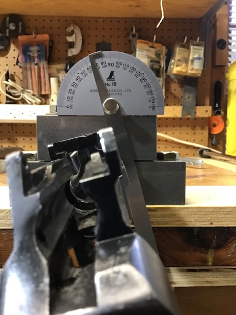

Measured the body under-turn at 15 degrees when snugged by hand.  Reynolds stated 18 deg was the requirement, but during wartime production, this varied a lot. The next size up breeching washer would put the underturn at over 20 deg, so I used the thinnest washer, 0.037 inches thick.
Action wrench fitted and bolts torqued, not as tight as barrel vice, not putting nearly the torque on the wrench to install the barrel as it took to remove it.
Torque action body to barrel until it is level with the front sight. I use a close fitting drill bit thru the back sight ears. The final tweak to align the body took about 100 foot lbs, an estimate, not using a torque wrench here. Had one foot up against the bench leg and gave it a good pull.
Action wrench and barreled action body removed from the barrel vice. You can see the two aluminum bushings here.
Headspace checked. With two layers of aluminum foil (.0013 thick total) the bolt just closes on the 0.064 GO gage, so headspace is a fraction over 0.065 inches with the same #1 bolt head, just where I want it. Bolt a long way off locking on the 0.070 NOGO gage.
All done…

I’ve not put the groove in the barrel yet for the front sight block band retaining pin.

Geoff, to file the groove dead square across the barrel; you could use a slave front sight support. drill the hole out slightly bigger than your file. So it can guide the file across the barrel. It would also prvent possible slippage and scrapes.
Impressive job by the way! looking forward to the range reports!
Date Posted: January 04 2024 at 11:02am
Like that idea Shaun! That’s exactly what I will do, I’ve got several spare block bands. Thank you for that suggestion.

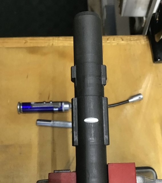

Got the front sight block band fitted.
Using Zed’s great suggestion, taking a snug fitting spare block band, I opened up the hole for the retaining pin to 7/64 inch, a very slight enlargement. I then used the 3/32 file to slot the band upwards away from the barrel.
That allowed the 3/32 file to slip in the modified band above the barrel.  Careful filing of the barrel with light downwards pressure using the band to locate the notch needed in the barrel for the tapered pin.
Remove the slotted band, install the original band and trial fit the tapered pin. Repeat as required until the pin was a nice tight fit.

All done.

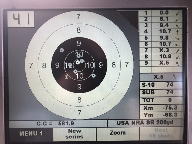

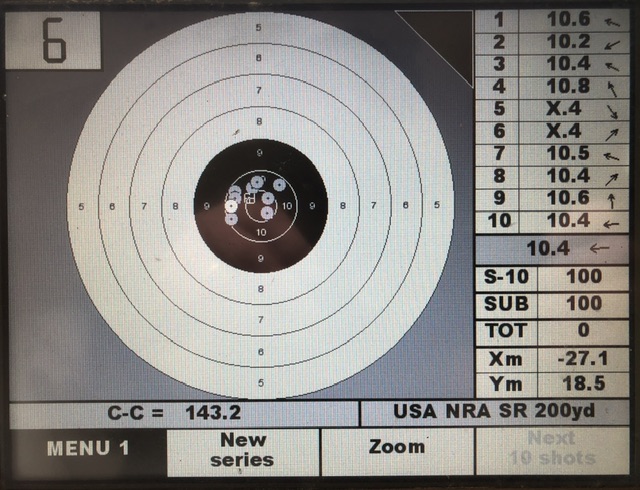

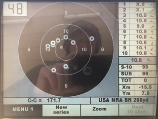

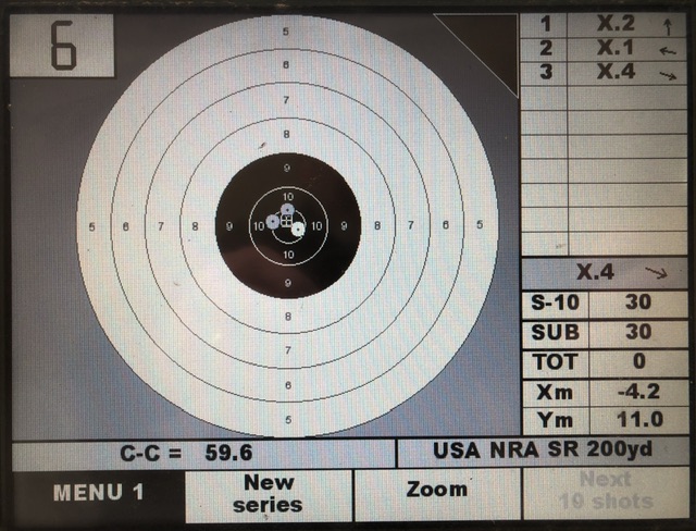

Got to the range today to break in the new Criterion barrel. It’s a tedious process, but pays dividends for the life of the barrel by being so much easier to clean.  I’ve proven this to myself on 4 or 5 barrels now, comparing no break in to a full break in.
The process I use is:
1) Fire one shot and clean, repeat as many times as necessary until copper fouling begins to reduce. Typically 5 to 10 shots.
2) Fire three shot strings and clean, repeat two or three times until you see more reduction in copper fouling.
3) Fire five shot strings and clean, repeat two or three times until you see little fouling.
4) Fire 10 shot string and clean. Break in is done.
I was able to do this today with 40 rounds.
I cleaned with Bore Tech Eliminator, it is easy to tell if there is significant copper fouling as the patch turns blue. Dark blue is heavy fouling. The first patch comes out black and is the powder fouling, second patch (and third) will be blue.  Once the third patch comes out with only light blue streaking, you know you’re close.

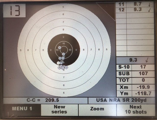

I’ll need to tighten the barrel another 3 degrees.  The first shot went left approx 7 minutes. This is the first time I’ve had that problem. On the five barrel installations I’ve done, the first shot has always been within a minute or two of center.  Also, the elevation changed considerably, by 9 minutes (low). I don’t have an explanation for this.  I’m going to measure the pressure at the forend barrel bearing (this rifle is center bedded at 5 inches forward of the chamber).
Once I fiddled with the sights, it started to put rounds in the x ring (200 yards), so I think this barrel is going to shoot.  This was the first 9 rounds, which I cleaned the bore between each shot with Eliminator.

I now have the barrel re-indexed.  It was indeed “off”. Not sure how. I set it back up in the barrel vice, this time used the top of the front sight protector to level the barrel.
Then with a close fitting drill bit thru the rear sight axis pin ears the barrel was indeed under torqued, by about 2 to 3 degrees. Just one degree of under turn results in a 2 MOA lateral shift (to the left) in the MPI.
Nipped up the action body a small amount at a time until the barrel and body were level.
Now to test for groups…

wow thats a lot of deviation per degree , glad you were able to get it corrected ,

Back to the range today. Cold front moved in last night, not the best conditions, but at least no rain.
Skies were clear.  This range faces south, which is the worst direction for this time of year on a clear day. The sun shines right on the firing point, and in the winter, the sun is more to the south so shines in your face. The targets are in the shade. I’m finding these lighting conditions harder every year to get a good sight picture. I far prefer to shoot on a cloudy day.
Tweaking the barrel indexing helped, but it still shoots a bit to the left.  First five shots with the front sight centered.  200 yards prone in the sling. Held good waterline, about 1 MOA vertical spread.
Adjusting the front sight and shot 10 rounds. I’ve zoomed into the 9 ring here for this photo. I called shot #5 to the right, that was all on me. Shot 8 and 9 was my attempt to hold slightly low as the previous 7 shots were grouping a bit high, over corrected.
It looks like this barrel is going to shoot, five of these 10 shots are within 1/2 MOA.

I now have 225 rounds thru the new Criterion barrel.  It’s not settling down, groups have been opening up. It will shoot perhaps 5 rounds just over 1 MOA, then throws fliers.  Many times, the first shots out of a cold bore land 3 MOA high and left.
Some groups are terrible, over 4 MOA. It’s not good enough for shooting the 200 yd vintage matches.
 Looking thru the 18 target plot sheets of ten shot groups, the best was 2.1 MOA. That is respectable shooting prone with the Mk 1 service sight, but not 4 to 5 MOA. It’s just inconsistent and not what I expect from a new barrel. It seems to “want to shoot” but something is just on the edge regarding bullet stability.
I don’t know what the problem is. I suspect it might have been the chamber finish reamer. This extended the throat considerably resulting in a bullet jump to the lands of 0.305 inches (174 gr SMK seated to 3.05 inches OAL).

I have rebarreled two M1’s and windage was dead on center using a spirit level to index the barrel and front and rear sights set to mechanical zero. Not on this first CBI barrel…foresight blade was all the way to the left such that the right side of the base of the blade was flush with the front sight block band. Not a good sight picture.

I suspect it’s the blown out eroded throat on the old BSA barrel, it’s got about 3/4 inch of free bore, lot of gas blow by.  Years ago, this barrel would produce 2370 to 2400 fps from this same load. Now it only produces 2290.
The CBI barrel has the exact same rifling dimensions of the BSA barrel (when it was new). Equal width of lands and grooves, 5 groove, 0.3025 bore.
Here is what the bore of the BSA barrel looks like, about 1 inch forward of the chamber, after a good clean with Eliminator, C4 and then JB.  Barely any perceptible rifling.  Surface flakes of steel are coming off in places from the firecracking, second photo about 2 inches down the bore. It’s surprising it shoots as good as it does.

For documentation purposes, I took some borescope shots of the throat on the 2nd new Criterion barrel. As received, and I do not intend to put the chamber reamer in this barrel.
A few small nicks where the reamer pilot touched/scratched the lands, but otherwise looks quite good.
Note that the .303 really has no “freebore”. The rifling leade (really, spelled “lead” but sounds like “leade”) begins right at the forward end of the chamber. You can see that on the SAAMI chamber drawing and in these borescope pics.
Here is the very end of the chamber, if you look around the outer edges of this photo you see the step from the case neck area onto the bore rifling. No length of freebore at all. The diameter at the origin of rifling (shallow as it is) is 0.3131 inches, a hair under full groove diameter. You can see the lightest of reamer marks in the groove just ahead of the chamber neck area. Then the first section of throat taper begins, followed by a slightly more shallow taper onto the full bore diameter.
Part way down the throat:
Here is the forward end of the throat. The reamer just touching the lands here at the full bore diameter of .3025 ish.
As a co-worker used to say to me, Geoff, this is way more information that you need to know!  On the flip side of that, I’ve learned from 40+ years in aviation structural engineering that the “devil is in the details”.

I pulled the old BSA barrel off the action body this morning. Checked the weight of the barrel, again, it’s within 1/4 oz of the new CBI barrel (2 lbs 8 1/2 oz).
This 2nd CBI barrel indexes at 15 deg underturn with the .040 (thickest) breeching washer whereas the 1st  CBI barrel indexed at 14 deg with the .037 thinnest washer. That’s going to lengthen headspace somewhat, but still well under 0.070 just in the hand snug position.
Got to put a small chamfer at the back lower edge of the chamber to keep bullet tips from getting caught, then ready to breech up the new barrel.
Date Posted: February 19 2024 at 9:37am
CBI #2 Barrel is now installed. I overclocked the barrel ever so slightly, about 1/2 degree. I did this to err on the tight side and move the MPI slightly right in case there is something inherent with the CBI barrrels shooting left like #1 barrel did.
Despite the thickest breeching washer being used, headspace came in very tight.  A sliver too tight. I’m using the shortest bolt head I have, a #0 that measures 0.629 inches. The bolt is touching the .064 gage just before the bolt handle contacts the action body wrist.
Here is the bolt handle position without the gage:
And with the .064 GO gage, note the sliver of light between the bolt handle and top right corner of action body wrist.
Not sure what I will do with this yet. There is no problem fully locking the bolt on cartridge cases, as it is very rare to get one with a .064 inch thick rim.  The options would be to grind .001 off the bolt face, hoping I keep it flat, find a shorter bolt head or ream the chamber.  I may just leave it alone.
Date Posted: February 19 2024 at 10:27am
Problem solved. I stoned the bolt face with a hard Arkansas stone. Holding the bolt head in my fingers and drawing it across the stone on the bench. Had no trouble keeping it flat. Probably removed only .0002 inch (two ten thousands). That was enough. The bolt rib now makes contact with the right side body bolt track when locked. But, there is absolutely no excess headspace with this barrel, it’s dead nuts on 0.0640 inches.
I also slugged the bore, the grooves are right at 0.313-0.314. It’s not a precise measurement as you have to roll the bullet between calipers with five groove rifling. It’s likely 0.3135.  The thin jacketed 174 SMK has no trouble upsetting to fill the grooves of that depth.

Here is group #4:
Had to fiddle with the front sight to bring the group onto target center, just very slight adjustments which I overshot a few times. Once I completed shooting the four 10 shoot groups I made one final adjustment and took three sighters to be sure I had a solid 200 yard zero:
The three shots fell at just over 1 MOA and in the X Ring. Good with that…

 So far, 85 rounds thru the barrel. It does seem to be settling down.  I found it interesting to see how the mean velocities increased, standard deviations decreased and group size decreased over these last 40 rounds.
My routine cleaning will be with Hoppes 9, cleaning twice a day for a few days, I’ll watch for any build up of copper and carbon in the bore and clean accordingly.

To explain what I mean about the LE “long chamber” vs a factory cartridge case, here is an example of a loaded Mk 7z cartridge. This happens to be a 1943 Defence Industries round.
The length from case head to the shoulder datum is 1.817 inches (Hornady Case Headspace Comparator).  The case above that in the photo is a new PPU case. It is also 1.817 inches.  I measured about 10 PPU cases and they are quite consistent in this dimension.
A fired case in this barrel (which came 0.010 inch short to SAAMI specs) measures 1.839 inches. That gives the cartridge case over 0.020 inch clearance at the shoulder. An additional final finish ream would increase that clearance to 0.030.  What you really want for accuracy is zero clearance, or even a 0.001 interference (crush) for accuracy. For reliable rapid fire feeding, I like to have at least 0.001 clearance.
Now, the other important dimension is the actual chamber length to the case mouth. That’s harder to measure without taking a chamber casting. But, what I did do is chamber a series of empty cases of varying lengths to see if there was any resistance to bolt locking and any tendency of the case mouth to ride into the step down into the throat. I checked this with pin gages to look for the case mouth closing up.
The chamber minimum length should be 2.222 from breech face to front of chamber.   With a case as long as 2.229, the case mouth was still not deformed when it was fully chambered (bolt locked).
The third check was to determine the cartridge OAL when the bullet touches the lands. Using a Hornady OAL Gage, the 174 Sierra MatchKing touched the lands at 3.098 inches, which is 0.023 beyond maximum cartridge length (3.075).
With all of the above and a correct size bolt head to get the rifle to headspace within specification, I felt there was no need to ream this chamber.

Update on how the new CBI barrel is shooting in the Long Branch No. 4 Mk I/3, now at a total of 485 rounds.
As this barrel breaks in, mean velocity is climbing and group center to center extreme spread is shrinking. Here is todays result prone at 200 yards, first group was slow fire and second was rapid fire:
Gp   MV    ES     SD     C-C     Score
 #   (fps) (fps)  (fps)  (MOA)
  1   2452  53    15.5   2.5     100-4x
  2   2426  62    15.8   2.5     100-7x
Standard match load:  PPU Case, WLR Primer, 40.0 gr Varget, 174 gr SMK, 3.05” OAL
Here is the prone rapid fire group:
I’m very impressed with the Criterion barrels. And excellent customer service as well.

I opened up the box that my Lothar Walther barrel was shipped in, weighed and borescoped the barrel. Here is what I found:
Barrel weighs 2 lb 8.75 oz. That’s about right on spec.
Rifling is 4 groove, RH Twist. Grooves appear to be a bit wider than the lands and are square edged.
The bore and the throat has obviously been hand lapped to a very good finish. I would not put a reamer in this chamber either.
Photo below is at the front of the chamber, bottom portion is the end of case neck annd top portion the origin of the rifling.
This photo of the throat, just slightly forward of the previous photo:
