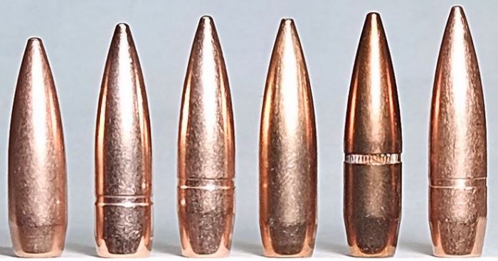

You can save yourself replicating a lot of the groundwork by making "britrifles" here one of your closest and dearest friends.  What you're writing about is essentially replicating work he's done and ground he's travelled over the last few years, including shooting Lee Enfields in CMP competition.
While you're awaiting him seeing your posts and showing up, search this website for his posts on load development, competing in CMP, etc.
The MatchKings are, I suppose, as good as any a place to start.  But CMP is mostly a close range game, unlike Service Rifle and similar military rifle long distance pursuits.  I would suggest that within the ammunition restrictions that apply to whatever matches you are shooting, expand your testing beyond FMJ bullets to find whatever works best.
We had "heritage matches" set up by an old Service Rifle competitor for a while in the 90's after the Canadian governments new regulations for AR-15s drove a lot of people to not want to bother with the "Restricted" requirements for transportation, licensing, ranges, etc.  It got off to a bit of a slow start because it was open to bolt action rifle with military history, but the ammunition had to be FMJ as well.  That was a nod to the history of the past, but a lot who might have competed and had their best loads with non-FMJ bullets like Speer Hot-Cor and Sierra GameKing didn't bother - they just stayed home.
Once the FMJ requirement was lifted, attendance dramatically increased when guys could show up to shoot the loads they had already developed.
As for FMJ, Privy Partizan has ALL kinds of FMJs for you to try other beyond just the old standby Hornady and Sierra FMJs:
Your Sierra Matchking is the one in the middle; the Hornady to it's right.  All the others are different flavors and weights of Privy Partizan - open bases just like the Mk VII ball round.
One other nice thing - cheap like borscht when compared to Sierra MatchKings.  If they group as well or better... definitely save you some money.
