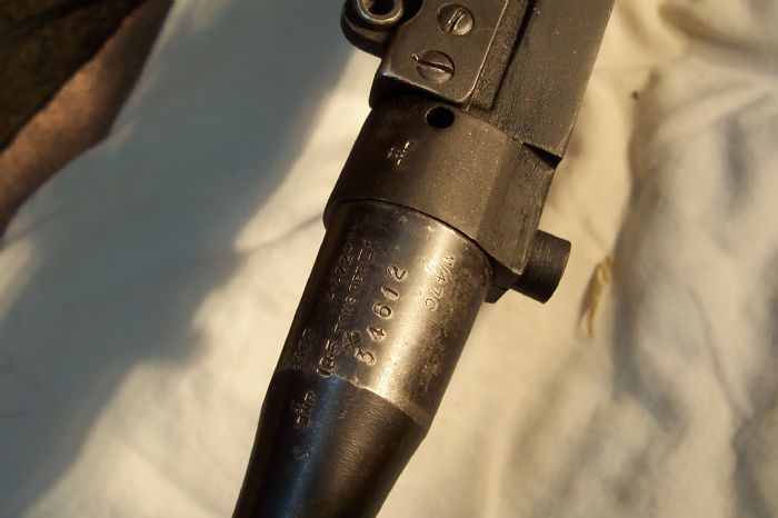

I was hoping it was modified it has all kind of marking on the barrel

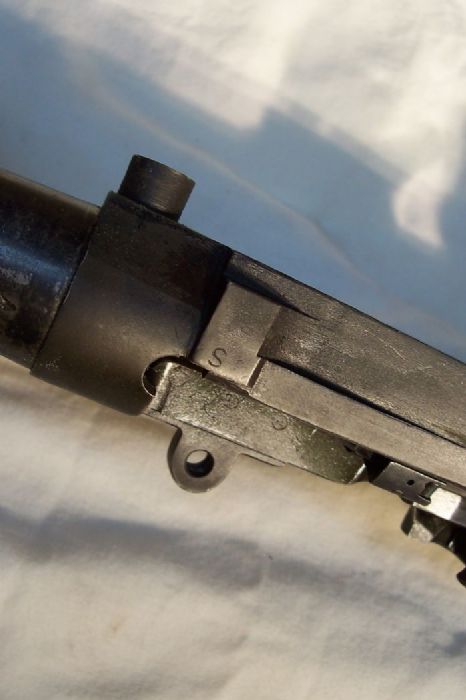

OP....we need many more photos especially the left wrist side near the butt/fore end area as well as the left receiver wall to help determine if that is indeed a sniper rifle. Is there an S51 stamped on the butt under the area where the butt fits into the socket?

This gun was built in 1944 serial#b346xx could any body tell me what month it was made

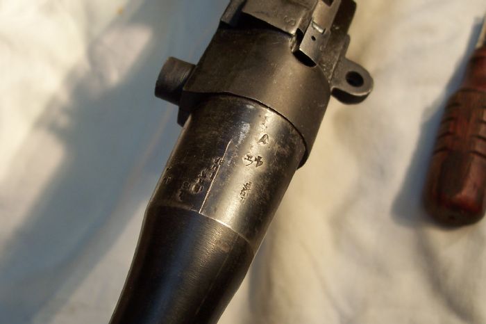

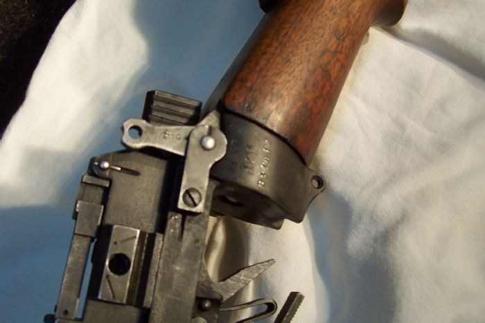

I am still having problems with pitures . This enfield was up grade from a mk1 to mk2

Date Posted: November 05 2017 at 2:03pm
the barrel will still handle new wood,the barrel is in excellent shape all# match.it was up graded from a mk1 to mk2.I do not know much about this stuff so am trying to get other people opinion I have new wood coming from the UK,and looking for metal parts. I would like to know the of month manufacture.

Date Posted: November 05 2017 at 2:32pm
You could certainly upgrade to original wood with a little hand fitting, but the missing barrel bits would make it a labor of love with a financial hit. That's fine as long as you realize you aren't "restoring value" somehow.
I'm curious why you think its a Mk1/2, though?
There's no bracket for the "hung trigger" of the Mk2.
Date Posted: November 05 2017 at 3:19pm
It's a 1944 model. There's no spot cut out in the receiver for the bolt head to turn out of. It's a No4 MkI, no asterisk.
Posted By: theodore711
Date Posted: November 05 2017 at 3:22pm
below bolt it is marked N.67 MK II
Ted S
Date Posted: November 05 2017 at 5:16pm
See where the bolt head is removed from behind the charger bridge. This is a Mk1.
This one shows the recessed cut behind the bolt.
This is a No4 Mk1*
The Mk2 has this recess and the trigger is hung off the butt socket. The Mk11 designation is something completely different. You'll have rifles designated No4 MkI,Mk2,Mk1/2,Mk1/3
Date Posted: November 05 2017 at 5:19pm
The serial number of yours shows it came out of the BSA Shirley plant. Late 1944 as a No4 MkI T

Date Posted: November 06 2017 at 4:20am
" The Mk2 has this recess and the trigger is hung off the butt socket"
Goosic.
I don't think you'll find any No4Mk2 with the resess for removing the bolt. That was specifcally for Mk1*; wartime production economy measures. Anything built after the would be using the release catch at the rear.
Theodore. If you are going to fit new wood yourself; I suggest you study the articles by Captain Peter Laidler that are available on the "milsurps" website. He is a retired British Army armourer and specializes in these rifles. it will gie you a good understanding of what you need to do to get the rifle in top shooting condition.
Date Posted: November 06 2017 at 5:08am
My bad.
Date Posted: November 06 2017 at 5:17am
OK, I understand. Each component had a mark #, its quite possible to have a Mk1 rifle with a Mk2 cocking piece & a Mk4 sight for example.
Your rifle is a Mk1 (no star) because the trigger is connected to the trigger guard, not the receiver & its not a * because it has a spring-loaded bolt release catch, instead of  cut rail.

Your rifle was a standard British BSA Shirley No. 4 Mk. I (T) and it has been sporterized after it left the military. The barrel has been shortened. Brian d**k (BDL LTD)in South Carolina  http://bdlltd.com/ " rel="nofollow - http://bdlltd.com/  ;  is your best bet if you are in the USA for restoring it.
If the scope SN matches the top of the butt at the wrist, and the bracket Sn matches the rifle, then it is a matched set and well worth restoring. A new barrel and new front furniture and fittings are straightforward. The increase in value would outweigh the cost of restoration.
