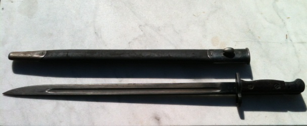

I have been offered this but there is no point if it is not contemporary to the SMLE I am after.
WW1 British 1907 Pattern sword bayonet and leather scabbard with pre-1915 lack of oiling hole to pommel.  Overall length 22.1/2in., blade length 17in. Blade to shiny grey patina signs of sharpening and also with many inspection marks, stamped with Kings crown, 1907 and the rare maker "Chapman".  Push buttton muzzle release works well with cross-guard and pommel to dark grey/ brown patina but without oil hole to pommel indicating pre-1915 manufacture.  The wooden grips are complete and in good condition with a stamped inspection mark to one side.  The dark brown leather scabbard has also got traces of a stamped inspection mark, the bottom steel chape and throat chape are to a speckled dark brown/ grey patina, the throat chape with an inspection stamp below the pre 1916 frog button. The whole in very good overall condition commensurate with age

Sounds like a good bayonet to go for, if the price is right.
As with many items of kit; bayonet's issued would not necessarily be the same date as the rifle; So as long as it's the correct type and era; should be OK.

Wait! "Signs of sharpening"?

I will post some photos for your perusal and the price is about £195 as it ia Chapman. ALthough, I have no idea whether this prce is right or not.

At that price I'd want it without the file marks on the blade. Why not look for a cheaper Sanderson or Wilkinson bayonet. They are more common so you'll probably find one in better condition for less money.

Yes, you are probably right. I would really like one dated 1915 and it doesn't need to be a Chapman, but in good nick. The sharpening efforts are a bit of a bodge then?

first off , yes , its 'correct' for the SMLE you are seeking , the scabbard is also correct for that time ,
second , it actually looks pretty nice if as said above price is fair ,
third , while chapman is one of the early makers , its not all that "rare" , i can give you a rundown of the makers and counts of production , but i would not steer you toward another for 'rarity' unless you had a really special rifle of some sort and were looking to get in deep , that one is a fine example for WWI ,

What are your thoughts on the fact the one I am looking at has had a sharpen in the past? I guess a squaddy may well just have sat there trying to put an edge on his bayonet.

Unfortunately, the sharpening of an '07 is most unlikely to have taken place during its service life and will certainly reduce its collectors' value. Under the circumstances I'd be inclined to give that Chapman a miss and as Zed suggested look out for a Snnderson or Wilkinson.

i agree , as a colector it would detract enough to pass , but with the reservation that what little i saw did not detract that much from an accumulators point of view , it was not excessine in the photo to me , if its to be an accessory to the rifle without its own intrinsic value as a key element [as mine are] i would make an offer on it ,
both of those other options would be easy to find i think , but i would not get too hung up on the manufacturer as long as its dated correctly for your needs ,
